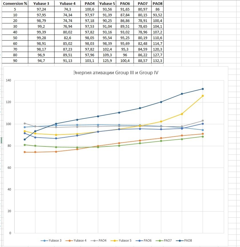

Бозон Хиггса писал(а): 04 сен 2018, 21:28 как видно что чем гуже жижа тем выше нужно портатить энергии (температуры) для того чтобы началось разрушение (крекинг). Тут указаны энергии для одного моль вещества
А вот если сводим энергии активации в одну табличку - то абсолютно не очевидно что "чем гуже жижа тем выше нужно портатить энергии (темпаратуры)"
Энергия ативации III и IV группы
Energy Activation III and IV Group.jpg (94.3 КБ) 10433 просмотра

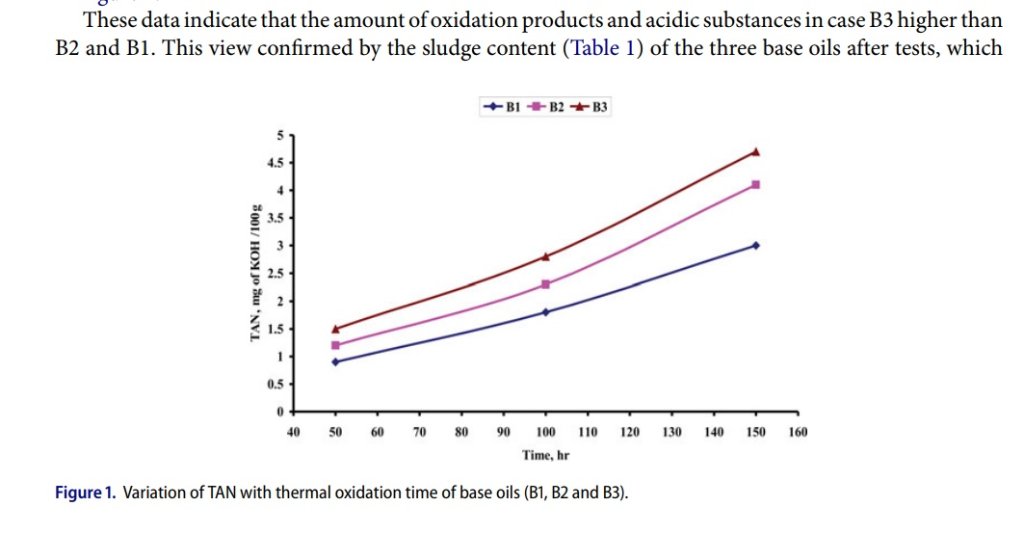

Ближневосточные товарищи пытали три минеральных масла разной KV100 с почти одинаковым индексом вязкости
Oxidation characteristic of base oils under investigation was carried out according to modified ASTM D943. The tested samples were oxidized at 150°C using copper coil as catalyst and flow rate 5 liter per hours for 50, 100 and 150 hours. After testing, the density, viscosities at 400C and 100°C, total acid number (TAN) and flash point of the tested oil samples were determined using ASTM methods D 1480, D 445, D 664 and D 92, respectively. The rate of oxidation was measured by the increase in total acid number and viscosity
B1 -  7 cSt KV100, VI  = 93<br />B2 - 11 cSt KV100, VI = 94 <br />B3 - 11 cSt KV100, VI = 95
TAN Base OIL.jpg (46.25 КБ) 10424 просмотра
e OIL.jpg[/attachment]
Как то вдруг и совсем неожиданно оказалось что
Oxidized base oil designated B3 is characterized by the having high viscosity, carbon residue, sludge content, flash point and total acid number, while base oil B2 has medium values of these characteristics, but base oil B1 is characterized by having high evaporation loss and low values of total acid number. The results obtained from determining the total acid number indicates that the thermal stability of base oils decrease with increase the heavy ends. In general, total acid number increased with increasing oxidation time.
Heavy oil has the lowest percentages of paraffinic hydrocarbons compared with the other light and middle lubricating oils which decrease with increasing interval times of oxidation
Т.е почему то более жидкая по KV100 база имеет большую анти окислительную способность.. :D :D Привет поклонникам малого NOACK и высокой FP из Египта и Саудовской Аравии :)

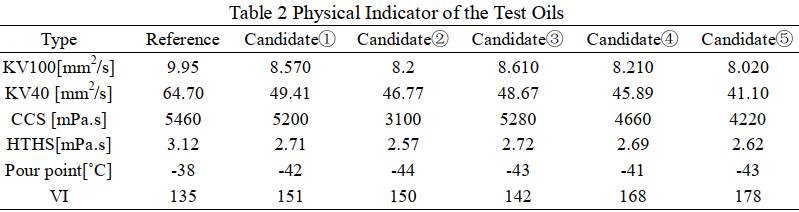

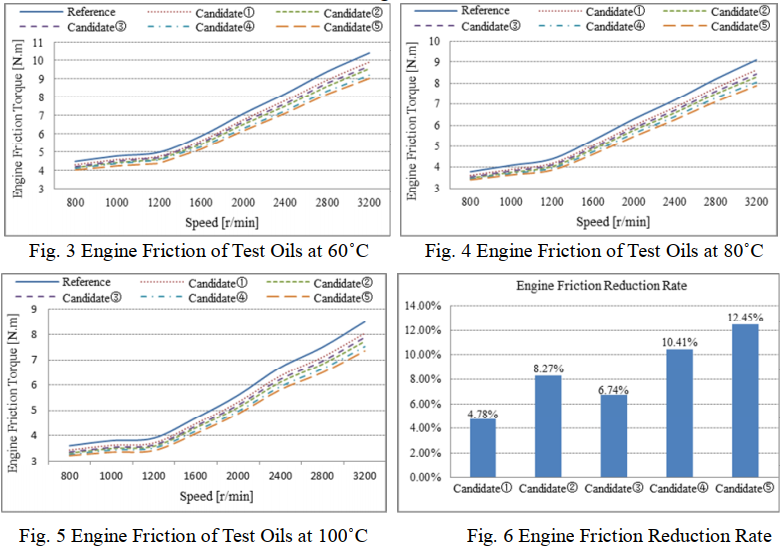

Экспериментальное исследование влияния моторного масла на трение и экономию топлива
Experimental Research on the Impact of Lubricating Oils on Engine Friction and Vehicle Fuel Economy
Выжимка в виде графиков
Особое внимание на графики Fig 6 и 10
График 10 - экономия топлива супернового dexos1 5w-20 составила 2,33% по сравнению с референсным 5-30 A5/B5
Если прикинуть, что при расходе 6 литров на сотню на A5/B5 при переходе на 5-20 вы получите экономию 0,14 л на сотню и расход 5,86
Как вообще такую цифру можно заметить замеряя просто от горловины или по лампочке в обычных условиях ? Это я про любителей петь песни про экономию в 1-2 литра

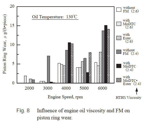

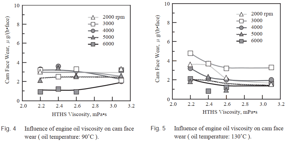

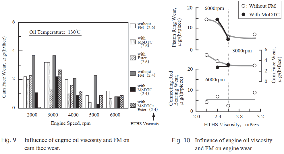

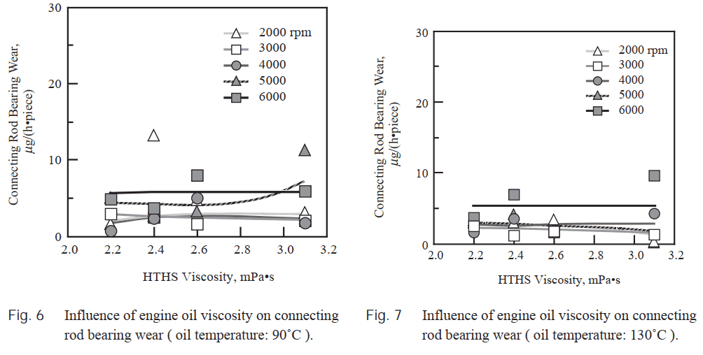

Каждый видит что хочет, но вроде как прослеживается снижение износа при температурах 130 град при росте HTHS
Любимые картинки кое-где и там их трактуют наоборот, смотрите мол как на 0w-20 все замечательно :D

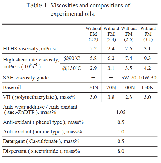

Влияние HTHS на износ
Low friction gasoline engine oil effect of lower viscosity and friction modifier
Износ поршневых колец при температурах 90 и 130 град
Износ кулачка распредвала при температурах 90 и 130 град
Износ шатунных влкадышей при температурах 90 и 130 град

Судя по этой картинке
что то и от эстеров, и от MoDTC нет особенного толка на высоких оборотах..
Т.е получается зря стритсракеры на своих корчах льют себе всякие гамногоночные масла с конской дозой молибдена и эстеров ...

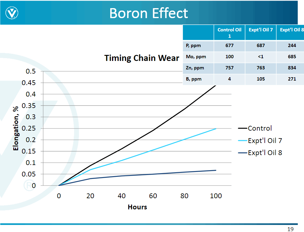

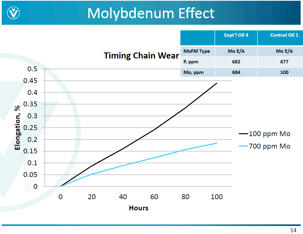

Влияние бора, молибдена, цинка, фосфора и прочего на износ цепи ГРМ
Если кратко, повышенные дозы цинка и фосфора увеличивают износ
Молибден уменьшает. Молибден под 700 ppm вообще хорошо для цепи. Бор также уменьшает, но не так эффективно как молибден.
Лучше всего использовать масла с 70 ppm молибдена, с бором и не высоким содержанием цинка и фосфора. Как-то так )
