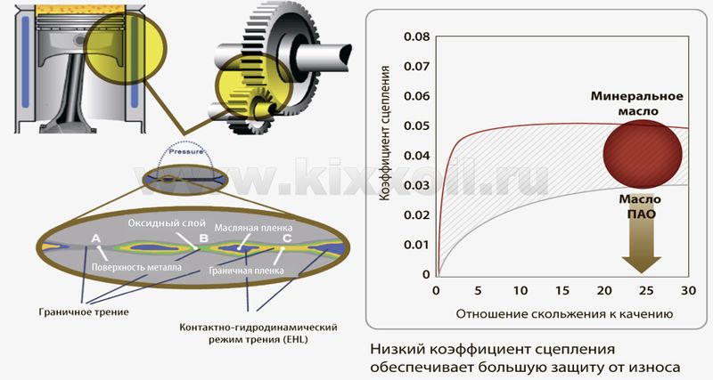

Есть разные мнения на счет ПАО
Защита от износа
Благодаря своей прочной молекулярной структуре, ПАО обеспечивают
эффективную защиту от износа поверхностей трения под большим давлением. http://kixxoil.ru/kixx-pao-5w-30-motornoe-maslo-4l/

1.5.2 Performance Testing for Automotive Applications
.......Both the thermal conductivity and the heat capacity of PAO fluids are about
10% higher than values for the comparable mineral oils. The net result is that PAO-lubricated equipment tends to run cooler. Fully synthetic automotive lubricants for engine oils, automatic transmission fluids, gear oils, and grease applications provide improved protection of hardware........
и тут же
1.6.4 Competitive Products
Chemically modified mineral oils (CMMOs) (highly refined mineral oils) approach PAO in some performance characteristics. These mineral oils fall into three categories - Very high viscosity index oils, High viscosity index oils, Polyinternalolefins....
(C) Synthetics, Mineral Oils,and Bio-Based Lubricants Chemistry and Technology
Leslie R. Rudnick Pennsylvania State University State College, Pennsylvania
ISBN 1-57444-723-8 (alk. paper)
