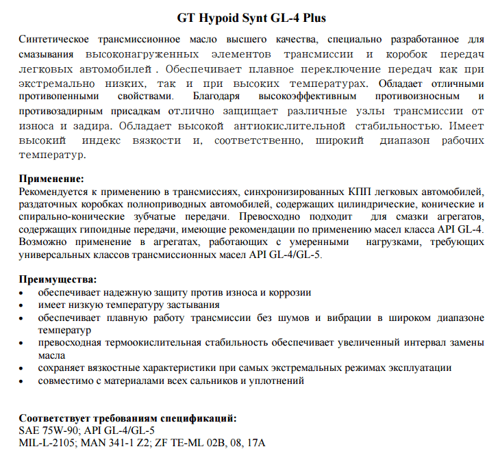

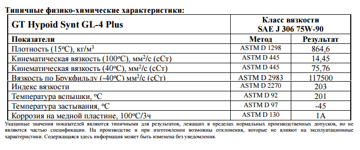

GT oil GT Hypoid GL-4 Plus 75W-90 (GL-4/5)
4л = 8809059407998
1л = 8809059407981
