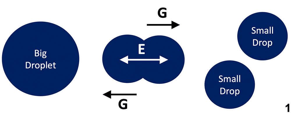

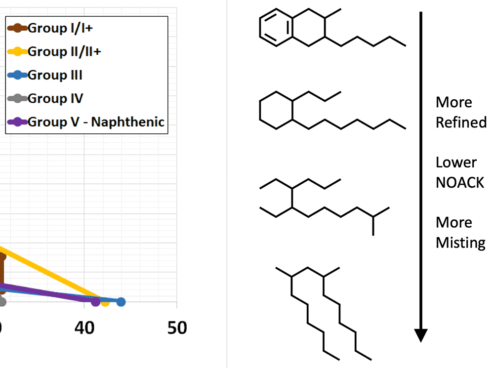

For the temperature range -5 to 40°C, multigrade oil viscoelasticity is independent of temperature. This has also been found for an idealised strongly elastic model fluid at temperatures between 21 and 110°C.
A group of multigrade oils with the same shear viscometric properties show significant differences in their viscoelastic behaviour. This lends credence to the concept that a "trade off" can be obtained between multigrade oil shear viscosity and viscoelasticity.
To characterise viscoelastic multigrade oil performance in journal bearing service applications it is recommended that the parameter "recoverable shear" (as defined in the text) be employed rather than just First Normal Stress Difference N₁.
• High molecular weight polymers exhibiting slight viscoelastic behavior.
• Exhibiting non-Newtonian properties.
• The viscoelastic cohesion prevents droplet fragmentation.
The presence of high molecular weight polymers in liquid solutions imparts viscoelastic properties to the system, resulting in the development of non-zero values of elasticity and shear modulus (E and G). These viscoelastic properties extend to the droplets formed from the solution, providing them with the ability to resist deformation and fragmentation. The cohesive network created by the polymer molecules produces a structural integrity that influences the E and G values of the droplets.
