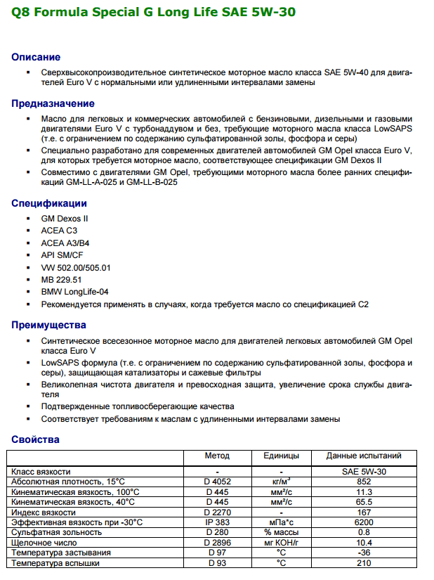

Q8 Formula Special G Long Life 5W-30 (SM, C3, 229.51, dexos2)
Домашняя страница продукта https://www.q8oils.com/en-us/en/mainnav ... rcars.aspx
101106401111 Q8 F Special G LL 5W-30 = 208 L
101106401301 Q8 F Special G LL 5W-30 = 60 L
101106401451 Q8 F Special G LL 5W-30 = 20 L
101106401654 Q8 F Special G LL 5W-30 = 4 L
101106401751 Q8 F Special G LL 5W-30 = 1 L
